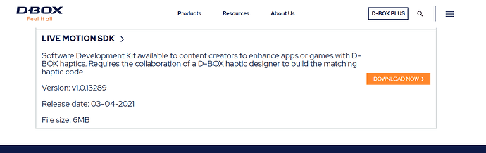

But when we run your sample exe under the LiveMotion SDK it doesn't work. D-BOX Status Led is constantly orange.
Likewise, our example code runs like that. Therefore, we think that th error is caused by the SDK or we have problem in integration.
